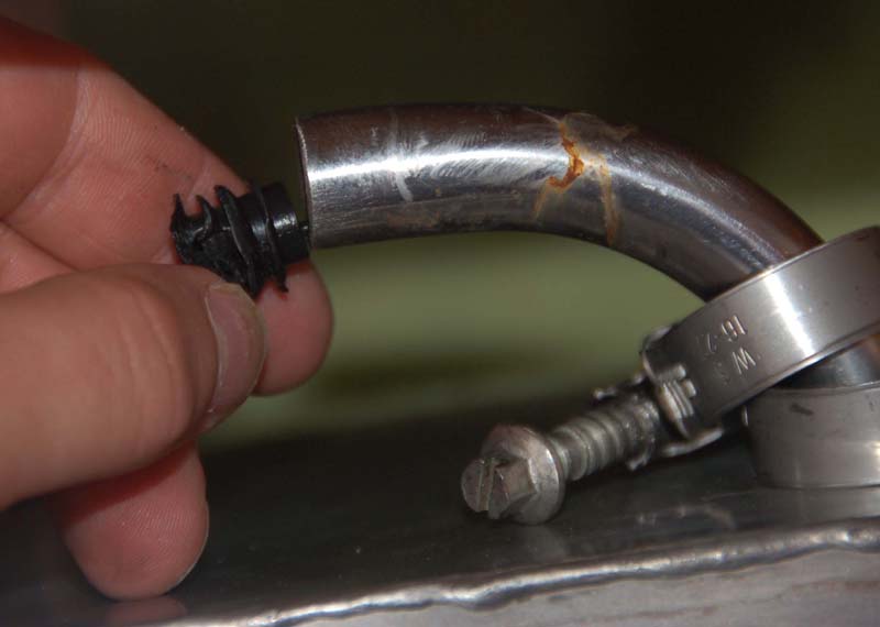

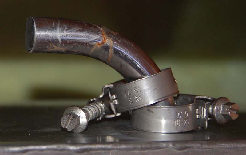

And speaking of plugged vents...
...here is the vent on the forward holding tank of my 400e.  If you look closely you can see the black plastic plug still inserted in the pipe...
...here's what it looks like when you remove it...
...this explains why the back-pressure seemed to build up a little faster in this one compared to the aft tank.  It also explains why we were sometimes finding a lingering odor around the forward head.
Believe it or not we have had the boat for one full season before we started to wonder if the vent might be plugged.
Also, the hose on this tank was 3/4 inch (19mm) internal diameter while both the pipe on the tank and the pipe on the vent were 5/8 (16mm).  I now have a proper vent and a proper hose.   The aft tank was all done properly but this forward tank was totally botched.  I've sent a full set of photos to my dealer in hopes that they will feed back the information to the factory.
FYI, ours is hull #042 -- if yours was built around the same time you might want to check it out.
We still love our Hanse but sometimes wonder who's running the production!
