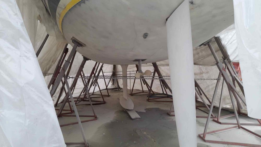

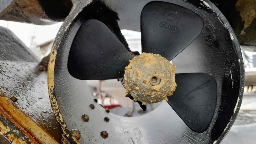

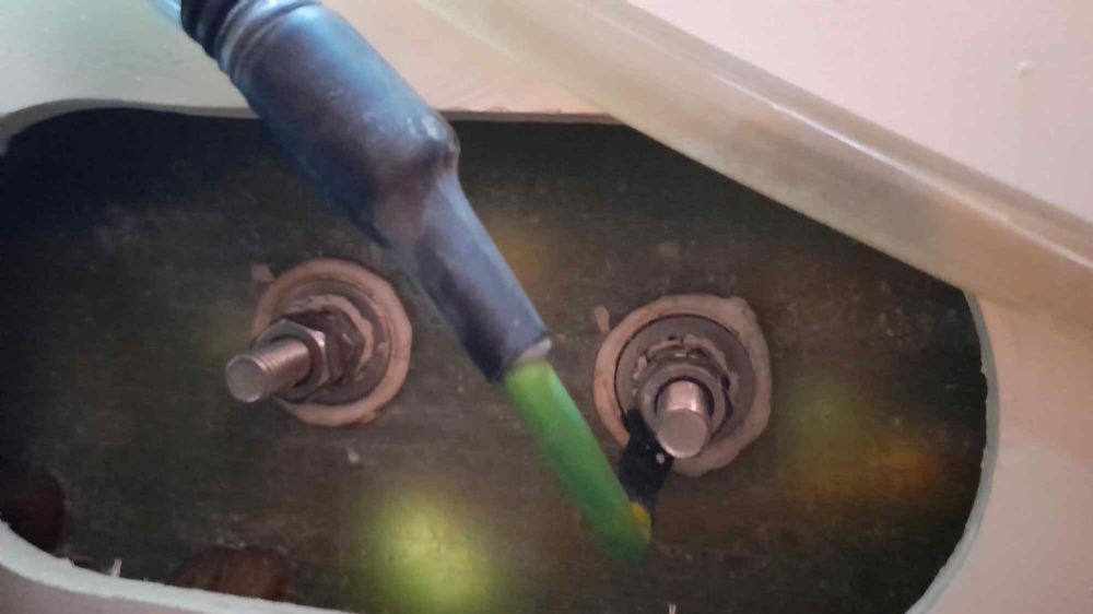

It seem I may have caused some confusion here so hopefully these photos will help BTW its a flexofold prop.
Rudder connection cable inside port cabin
Saildrive anode, there are also two small button anodes at the top and bottom of the prop in this position
Hull anode / grounding plate

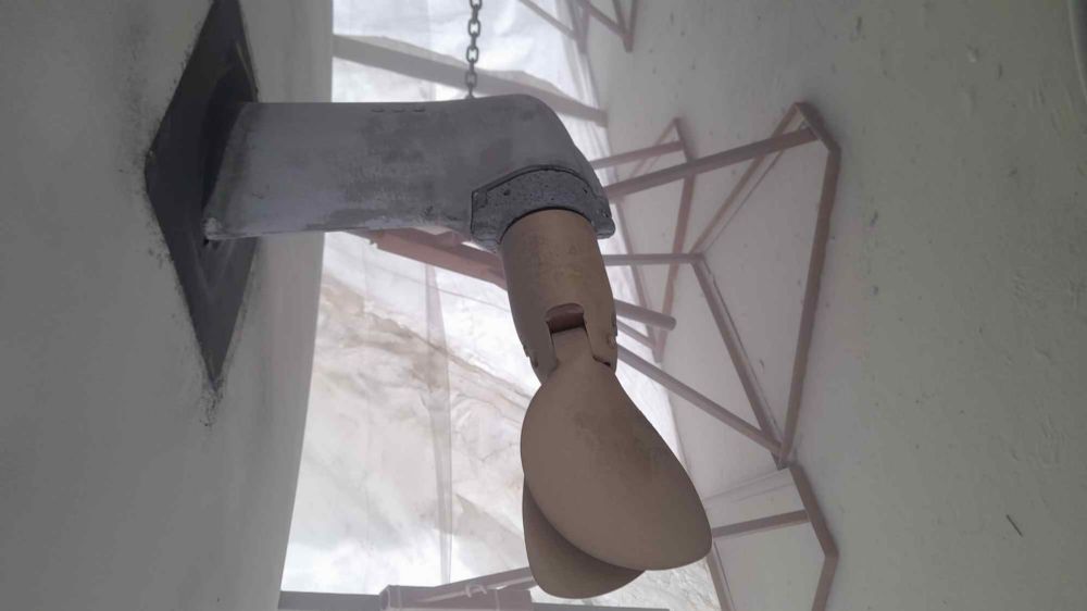

EDIT2: - See picture of my retractable thruster below (Max Power Compact Retract - different brand than yours). No anode like yours, looks like one is missing, but pictures from manufacturer online suggests that there should not be any anodes on this model.

Hi your are right this is from the Max Power compact retractor manual
"The composite drive leg is prefilled with oil from the factory, which does not need to be replaced. Due to its composite material the drive leg does not need an anode for protection. When the boat is ashore, check for evidence of fishing line, etc. in the propellers"
So one less thing for you to worry about!!!Smile

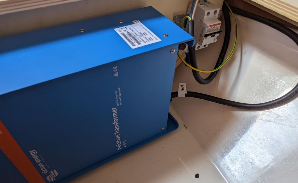

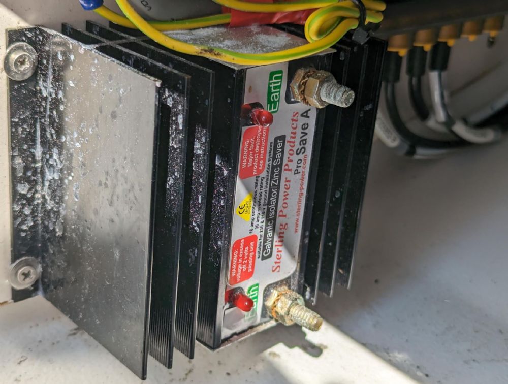

Hi, did all of you guys also get a boat with this questionable galvanic (diode) protector under the portside cockpit seat?
In my case it was defective and I replaced it with a proper transformer installed in a more electronics friendly environment.

My 2021 458 has a Pro Marine ProSafe FS30. Galvanic Isolator.  Looks professional.  I don't recall the brand from my 2015 385 but it was equally substantial.

Posted By: H8jer
Date Posted: 15 June 2023 at 13:00
Hi Schjell
Are you sure it was defective? The manufacturer has sold 500.000 with 0% failure rate according to their webpage:
https://sterling-power.com/products/zinc-savers-galvanic-isolators" rel="nofollow - https://sterling-power.com/products/zinc-savers-galvanic-isolators
I have installed this kind of Sterling Zinksaver in my current and previous boat. It should only lit the diodes if it is defective or the voltage exceed 2 volts.
This Sterling Galvanic Isolator is much better than nothing...

To be honest, the previous owner had disconnected it because he said it was faulty. He rarely used shorepower anyways.
The 2kW Victron i bought was approx NOK 7000 + NOK 500 for the 10A 2-pole GFCI.
I didn't go for the 16A transformer version due to its size and what I actually need. Might add a switch later that bypasses transformer if I need 16A for shorter periods of time.
