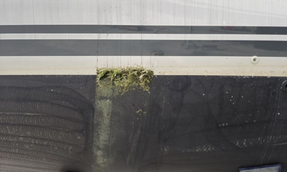

Posted By: sasabbat
Date Posted: 05 May 2025 at 04:51
Is this photo related to the boat leaning on port side?
Water in the balsa core?
ss
Posted By: Wayne's World
Date Posted: 05 May 2025 at 05:44
SS,
I would think the photo shows growth which was covered by the lift strap after the boat was pressure washed at the start of its haulout. Shows the growth well above the antifouling line.
Wayne W
Cruising, currently in the Pacific until the end of 2026.
Posted By: sasabbat
Date Posted: 05 May 2025 at 05:46
Oh, thanks!
That makes sense.
ss

Only the line of the growth of mussels is not a correct indication that the boat is leaning one side.After some time in a Marina with most off the time the wind ,swell and sea on one side of the boat can make a difference in growing.
Only 2 AGM battery our differences in tank(almost near the center and low in the bottom of the boat) will not make big difference in leaning one our other side by this size and the displacement of a 46 feet boat. My 2 c
