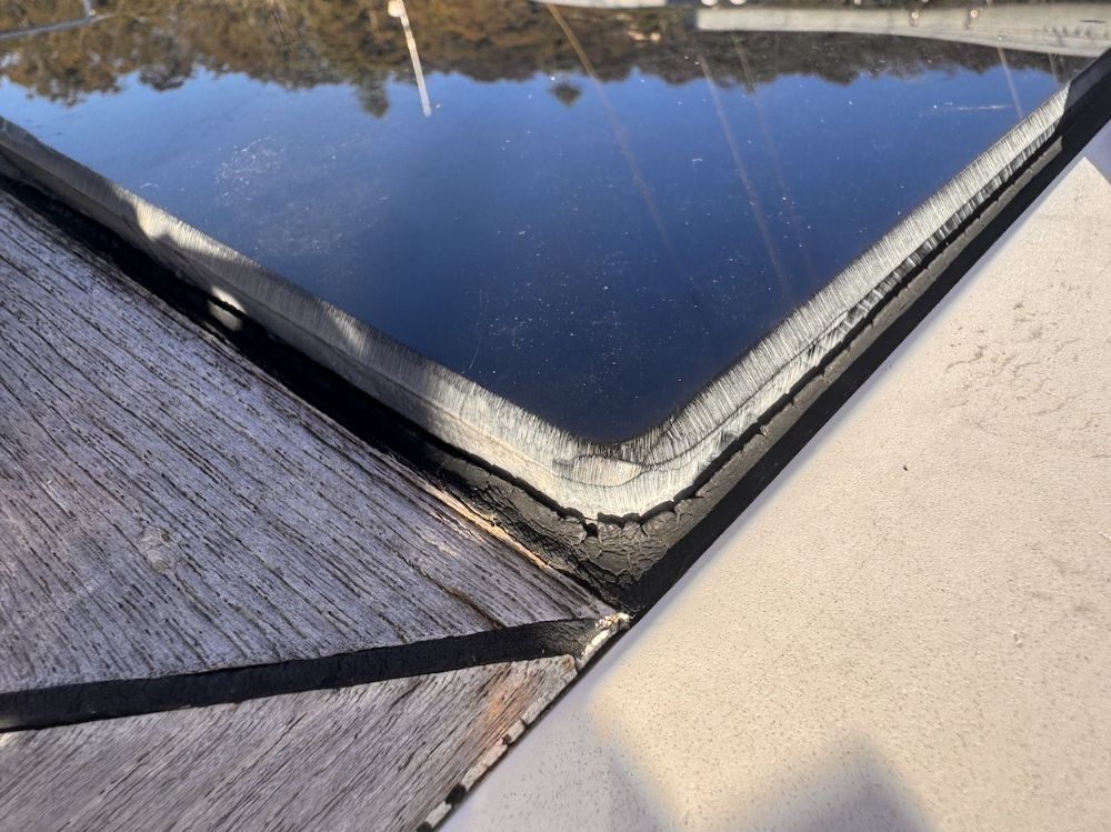

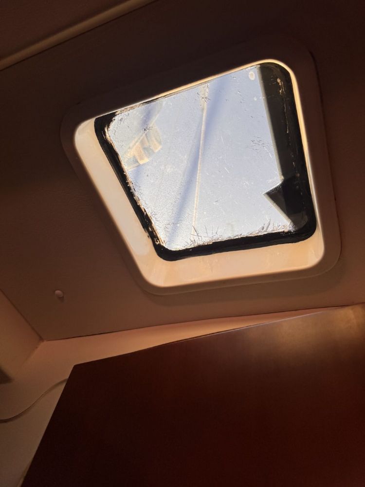

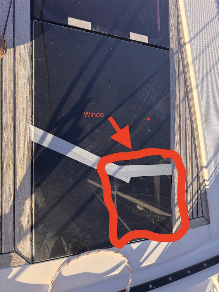

Hi Guys,
I have a hanse 430E 2008 model. The acrylic on the fordeck over the forepeak cabin and the ensuite head has cracked and delaminated. Its starting to come away from the coachroof. Im told its a regular issue with this model. Ive been quoted $1700AUD by the hanse commisioning shipwright in Australia to remove and replace with 2 pieces as thats part of the problem that theres only 1 piece and expansion and contraction causes problems. Its quite expensive and im hoping i can do the work myself.
Has anyone else done this? Or is anyone familiar with the issue?
Im going to try to post photos below if i can resize them small enough.
Sydney Australia

First off,  Mine is also cracked.  2007 430e.  I have filled the cracks with superglue as a temporary fix until I can get it taken apart.  Also moisture has gotten under the acrylic.  I expect that it will require cutting around the acrylic with a knife and prying out the piece(s).  Then buying a new piece of acrylic and using sika to seal it back in.

My shipwright is very familiar with Hanses as i said. He said that they either replace it with 2 or 3 new acrylic pieces as they expand and contract with thermal forces which is why they become unstuck but with multiple pieces it works better, he also said not to use sikaflex as its not UV stable enough and from my experience also sika needs a blackout primer on the acylic but there are other options im sure but he hasnt told me what they've used before. Sometimes they've replaced the whole thing with a 1 piece of teak which is expensive.

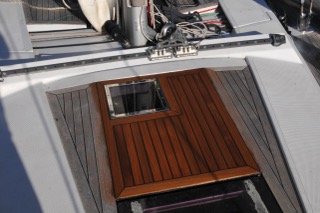

Posted By: Lykke
Date Posted: 19 December 2025 at 15:38
Hi, on my boat it did not crack, but become loose after several years exposed to sunshine.
As mentioned in another post, I made a smaller window with teak around it:
This is how it looks today, a few years later:
I still have the original plastic sheet if someone near me has a cracked one they want to replace.
Lykke, Hanse 430e, #8 from 2007
Posted By: Dogscout
Date Posted: 20 December 2025 at 00:55
That looks great.  I just received the new piece of Acrylic yesterday.  Shipped from NZ to Fiji only took a month.  Sadly I'm heading to the US today and will not be replacing it until sometime in February.  I wish there was someone here that is good with teak.  Oh well.

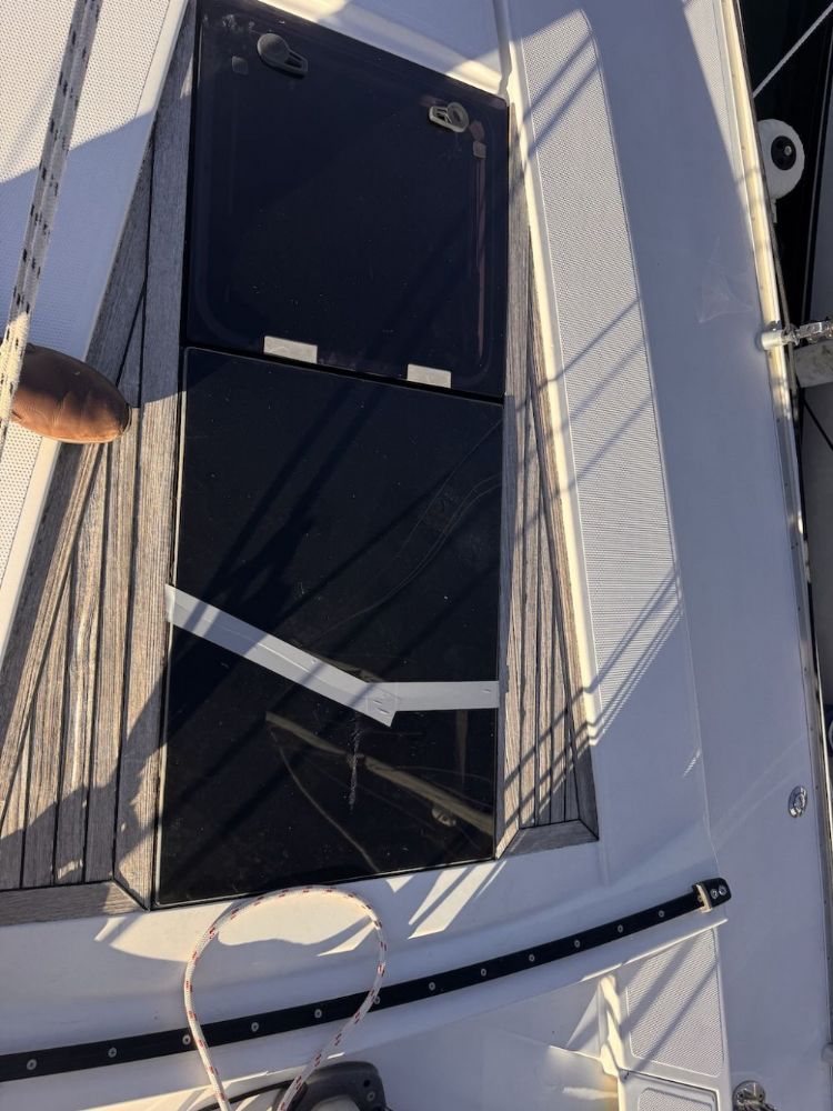

Date Posted: 22 January 2026 at 21:55
Issywa.  Mine was extremely difficult to remove required breaking it in many pieces.  So I got back early and started the project.  I saw some areas under the acrylic were like a damp sponge and the sika came off easily.  Other portions were stuck fast and required a hammer and putty knife to get under and then break away.  It was the area towards the bow that was the easiest and had water between the acrylic and cabintop.  I ended up using 1 panel of the same size as original but is 6mm thick.  I believe the original is 4mm.   I used Sika 295UV which is supposed to be more UV stable.  I also removed the front hatch and like others the powder coating was stuck to the sealant and not the frame.  It's all back together now too.  I need to clean rhe boat but the Pic shows the new panel in place.  And yes there is some moisture under it arrrrrgh it was hot and sweaty here in Fiji yesterday.
