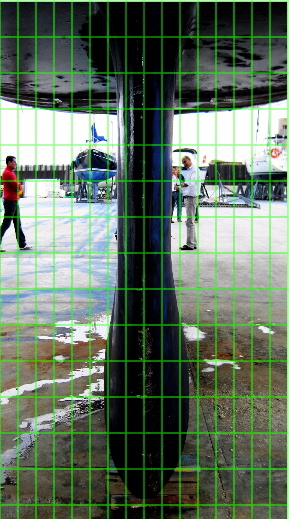

Dear Hanse owners
What is wrong with this picture?
How could a half a million Euros Yacht be delivered like this?
ZENCAP
ZENCAP

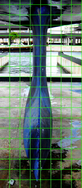

Posted By: ZENYACHT
Date Posted: 29 July 2009 at 23:19
Dear Fellows
Another view so you can have a better idea of what was going on
ZENCAP
ZENCAP

Posted By: panos
Date Posted: 30 July 2009 at 18:16
Possibly our second in command could fix it when he returns from holidays.
To be serious: what is the problem : bad keel installation or bad keel construction.( I assume it did not deform while sailingDead.)
Panos
Hanse 630e - selling her -
Posted By: ZENYACHT
Date Posted: 30 July 2009 at 21:20
Dear Panos
Both.
ZENCAP
Originally posted by panos panos wrote:
Hi,Possibly our second in command could fix it when he returns from holidays.To be serious: what is the problem : bad keel installation or bad keel construction.( I assume it did not deform while sailing[IMG]smileys/smiley11.gif" align="absmiddle" alt="Dead" />.)
ZENCAP

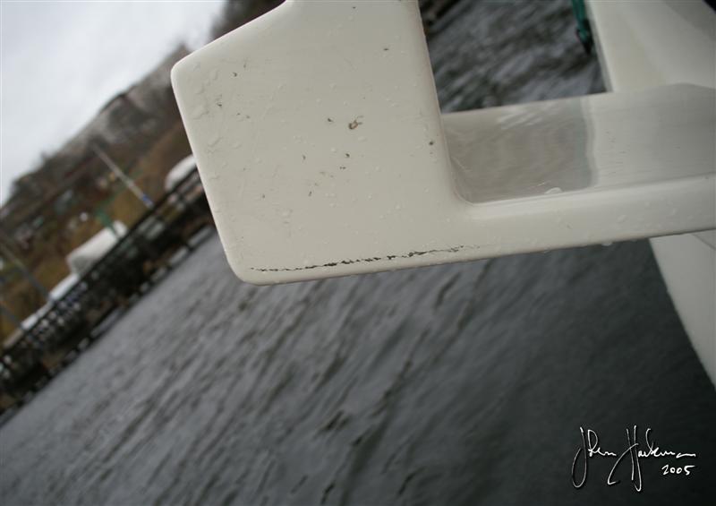

The below picture shows my bath platform when my boat was only three months old. I agreed to take the boat back to my dealer to get it relaced but they did nothing about it. Then I sailed to Greifswald but they did nothing. After a year Hanse's after sale told me that they were making priorities to new production. The first time the bath platform was replaced was 15 months after the picture was taken, but it cracked already after four days. It wasn't until two years after the picture was taken the bath platform problem was solved and that involved rebuilding the cockpit bench to make the bath platform fit.
