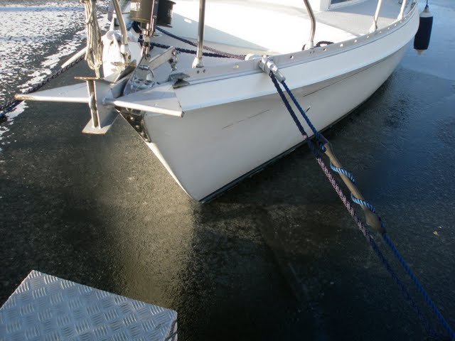

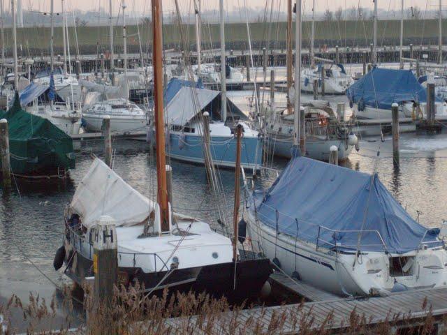

Posted By: Stella*Nova
Date Posted: 04 November 2009 at 10:38
Originally posted by silversailor silversailor wrote:
Ralf,
If I could I would.  That is, if I could leave Legacy in the water over the winter I would.  However, our river freezes over so I would need to operate a "bubbler" to maintain some open water around her hull.  Since I'm 1200 miles away during the winter, I'm not comfortable relying on some electrical devise to maintain my boat.
But frozen water should be no problem for the boat if the water doesn't move. In our habour they use the bubblers but not in all sections.
The harbourmaster told me, in 30 years only one time they had a problem at one boat, cause the owner didn't fill the valves with antifreeze.
The photos are taken at January 2009, all at the same day.
BR Ralf, Ex. 'a mare' H370
