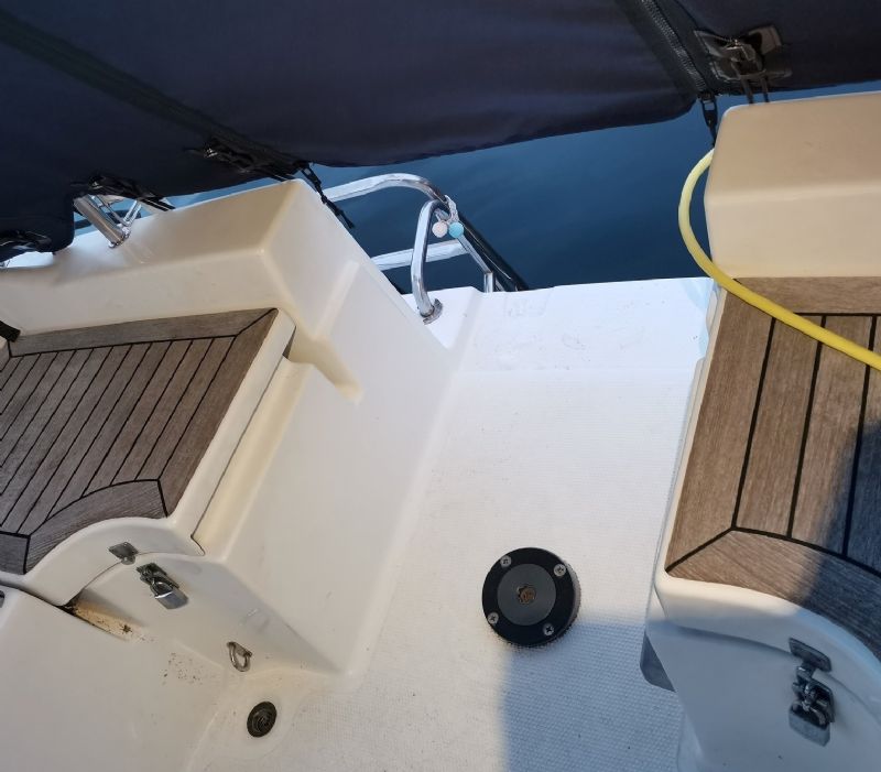

Ole, here's a picture of the final result. You can hardly detect the repair.
Another thing I will do is to shorten the stainless support to make the bathing platform level and possibly put some protection on the transom. The platform is quite heavy and has left marks on the transom.

Date Posted: 07 June 2017 at 21:37
It's time for an update.
Another six years have passed since my bathing platform problem was "finally solved". I am happy to say that the cracks have not reappeared. It is now strong enough to be used as initially intended.
However, some new cracks have appeared along the hinges. As the hinges are screwed into an aluminium plate moulded into the GRP, and the stress is great in this part of the platform, this part has kind of separated.
The solution, as seen in the picture below, is to pull the screws all the way through with a washer and a nut on the other side.
Posted By: kirkelund
Date Posted: 08 June 2017 at 19:34
Hi Johan
Yep - that must be the best (only) solution even if the nuts stick out a bit.
No surprise, I have exactly the same cracks on the exact same spot on my platform. So maybe it's time for me to do the same operations as the ones you didErmm

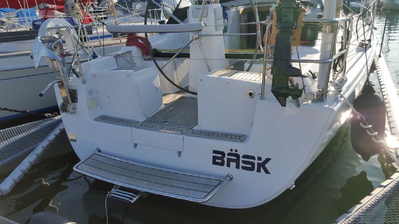

Posted By: Borjebus
Date Posted: 13 June 2017 at 20:22
My strongest recommendation is to remove the original platform and replace with something like I did on my 370, inspired by Marco.
It saves your back and makes it easy to handle things on the aft. It is also a lot easier to get out of the water if something unfortunate happens.
To hide holes from hinges and the old ladder I added three pieces of teak - looks very nice.
BÄSK, Hanse 370e #82 from 2006, Yanmar 3JH4E/SD50, 3-blade Flexofold, RMC(Lewmar) 185 Bowthruster, Vulcan 9, Simrad+B&G instruments
Date Posted: 16 June 2017 at 19:17
Hi Borjebus
The platfom looks great.
It's a more traditional (and proven) construction, so it will probably lastThumbs Up
Actually it also provides a little more space in the cockpit, which is nice while in the harbour (I often lower mine when in harbour). However, I like the closed transom when sailing.... and so does my dog, "Dante". It is his favourite hiding place when sailing and I don't want to "cancel" his little "cave". See below (pictures are from his first season at sea). Big smile

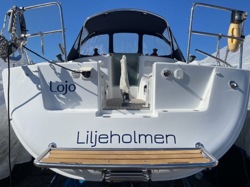

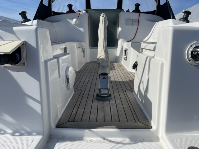

Posted By: Jojo
Date Posted: 20 March 2023 at 06:48
hello friends
Today I purchased a new bathplatform to our 342
I went the Batsystem route (35 series)
The feeling of a platform that is useful in multiple ways not only for easy access to the boat
Actually 2 persons can sit and relax together
The rubber boat can easily be stored resting on the platform upright under sailing in the Swedish archipelago
To my surprise the original wasn’t useful and quite heavy handled for my family
I must say the boat feels larger only by removing the old platform (like the open sight backwards) as we have the tiller version
To all that being in doubt to remove the old and make it more usable
It’s a affordable option instead of a repair or original replacement
155 x 45 cm is a lot extra space
Regards jonas
