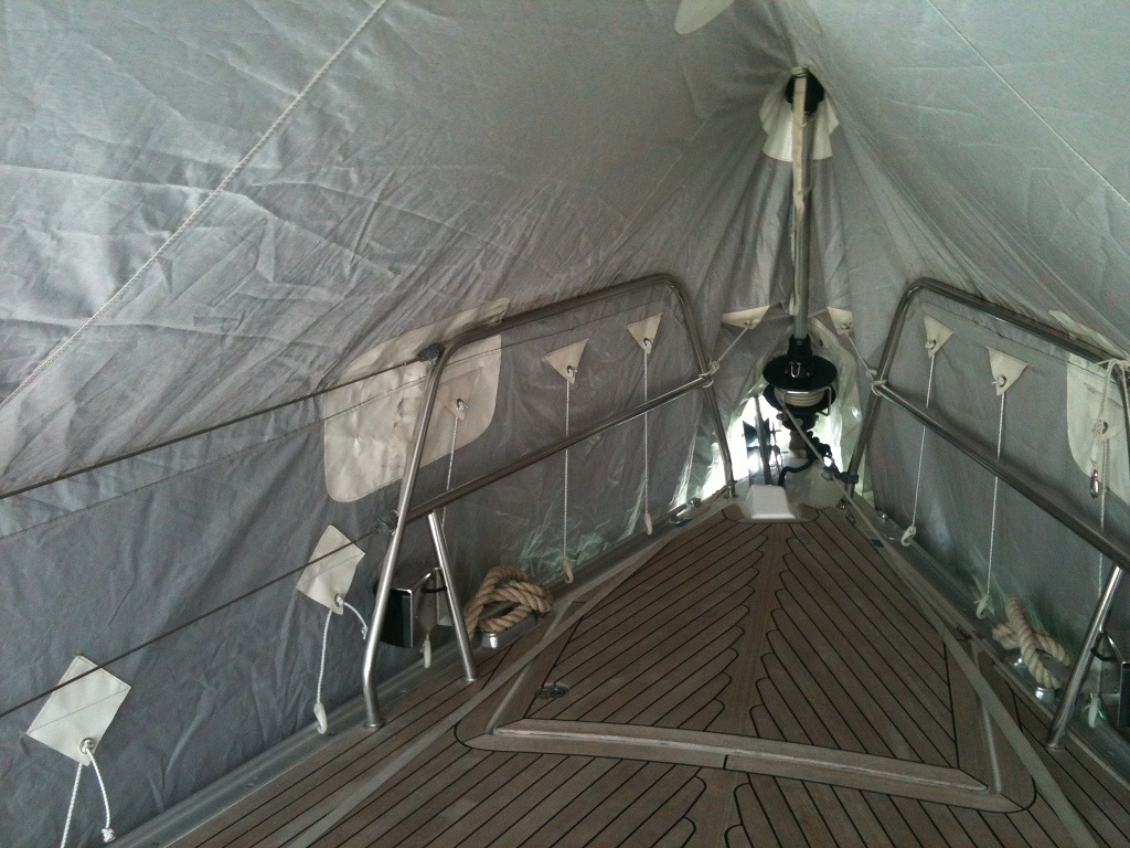

Dear Pearl,
I leave my boat in the water all the year execpt for maintance in spring. I ve used a cover as you can see on the picture for the last 6 seasons. I can tell you that hts cover gives perfect protection not only in winter but as well in summer against the UV radiation. So far I had no difficulies with humidity. It takes me aproximatly 1 hour to put the cover on the boat. For sure it is only a 370e so for your boat it will take a few minutes more. The cover is made out of 3 pieces from bow to mast; mast to boomend; boomend to stern. Easy to handel for one person.
Manufacturer is company wendling. See their internetpages (only in German): http://www.bootssattlerei-wendling.de/segelboot/persenning/index.php They have done the cover for my boat a bimini and Sprayhood in a perfect quality.
Best regards
HP
Sorry for the bad quality of the pic!

Sophie - that looks exactly as i expected.
Are you using the cover with or without the main sail on the boom?
How do you hold the cover down along the hull? I was thinking a bucket in the water? weighs nothing, but will pull with its capacity when the wind lift the cover.

Hi Pearl,
I use the cover with the Main Sail on the boom.  I just loose the ropes of the maindrop and the complete maindrop is moving downward. To do so the ropes needs to be long enough.
The cover is with severral rubberbands and small plastic hooks attaced to the toe rail. Approximatly one each 60cm.  At Bow and Stearn there are additional ropes to hold it down. In addition it is possible to attache some small sandbags at the lower side of the cover. I got this sandbags delivered with the cover but never used it. That Solution works perfect even in high winds. (The toe rail is different on my boat than on yours) I try to make some detailed pictures when I am nexttime on my boat.
Best regards
HP

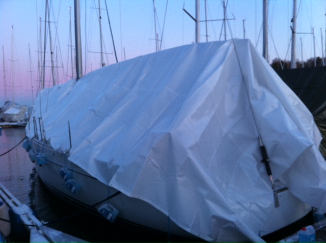

Hello;
Yes a bit out of season but still a very important issue in colder climates.
Here in Norway most people cover their sail boat during the winter season. You can buy racks which gives the cover support in the same way as a tent does. To keep the cover down, most people use cans with antifreeze liquid. Antifreeze is used because frozen cans can damage the hull when they move in wind etc.
Many people also keep their boats on land during the winter. When you do this you have to go through a procedure of emptying all water and preparing the engine for freezing temperature. On my old boat, I choose to keep her in the sea but made sure the temp inside always was above 0 degrees.
The above pic showes how I did it last winter on my old boat.
