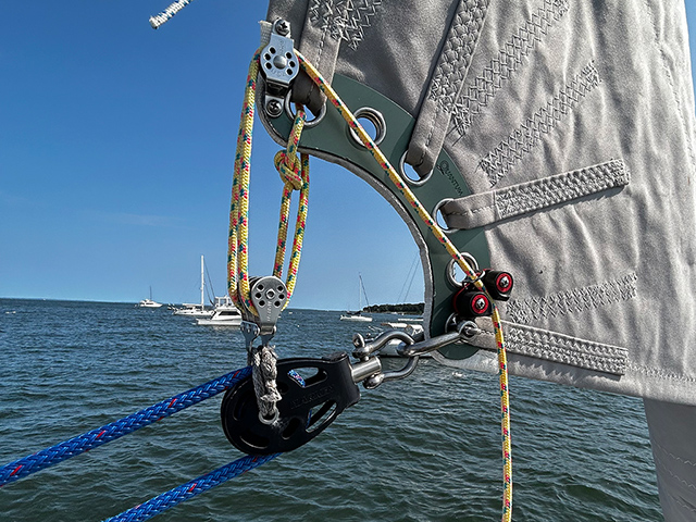

Adjustable Clew Board on self tacking jib - I do a bunch of local buoy racing as well as some longer distance racing with our Hanse 418. I miss the adjustable jib cars on our last boat so I came up with a block system that I have bolted onto the sail. Tighten for light winds, loosen for heavy wind. If something breaks, sheet block will swing to the heavy wind setting.

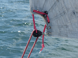

Have a look at the interesting link within  https://www.myhanse.com/topic14468.html" rel="nofollow - Self-tacker - adjustable clewboard - myHanse - Hanse Yachts Owners Forum
I use a lightweight Harken block and a soft shackle in 'normal' mode anyway; reduces weight, risk of injury and is much easier to handle.

I started with this configuration: , But I found I could not adjust it under load while watching my Leech shape.
