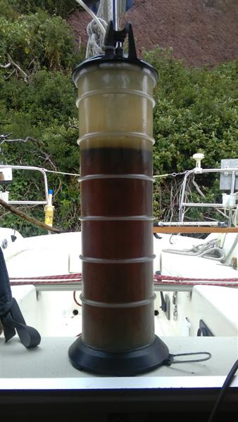

Posted By: Bitbaltic
Date Posted: 28 June 2017 at 21:24
Well now it's my turn to join the list of 301 owners who have found this void full of water. We had a failure of the heads outlet seacock which kept leaking whether open or closed. Boat has been out of the water to have all the (original non-DZR) seacocks replaced with DZR type. Anyway, the leak from the seacock got in between the hull and inner moulding and, just as for others, appeared in the bilge inspection area beneath the saloon table by flooding through the bilge pump limber holes between the bilge "proper" and the hidden compartment which, of course, it had filled to the brim.
Marine engineers drilled a hole following the pictures provided by perry and pumped out about six litres of water.
^Water pumped out
^ New "inspection hole"- for periodic pump-out.
