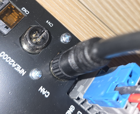

Posted By: Typ2003
Date Posted: 07 November 2025 at 04:46
I’ve just received my boat and activated the Sentinel system.
At the moment, I can only see basic information such as battery voltage, shore power connection status, and bilge activity, and I can control only one light.
As shown in the attached photo, when I opened the back panel of the Simarine Nereide2, I found that nothing is connected to the NMEA2000 port.
I also checked inside the boat but couldn’t find any existing NMEA2000 cable.
I’ve ordered an N2K T-connector and cable. Once I connect the Nereide2 to the N2K network, will I be able to see data such as refrigerator status, external lights, and bow/stern thruster battery voltage in the Sentinel app?
Also, I’m wondering about the Sentinel subscription — should I stay with the basic plan, or purchase the CZone Lite or Unlimited option? What is the actual difference between them?
