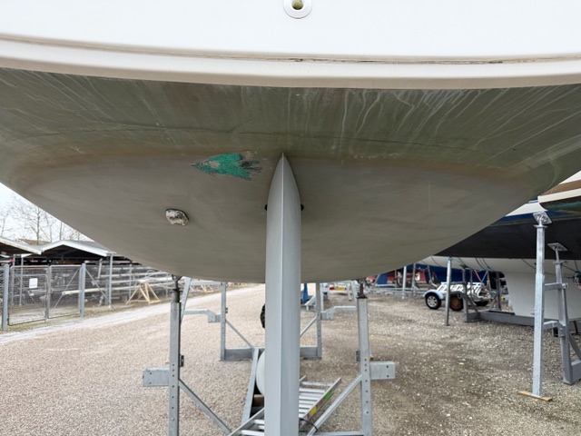

I recently noticed that the top of the rudder is rubbing the hull when turning all the way to port, but not when turning to starboard.  Centered clearance is small (about 1–2 mm), and when turning all the way to starboard the gap still looks around 1–2 mm.
However, when turning to port the clearance gradually decreases and the rudder just begins to rub at full lock. Steering feels completely normal, and I don’t recall any impact, although there is some antifouling rubbed off on the upper port side of the rudder.

Posted By: spam
Date Posted: 23 November 2025 at 16:00
I don’t recall any impact, but there is some antifouling rubbed off on the lower part of the rudder (see picture). It doesn’t look severe enough for the kind of force I’d expect would be needed to bend the stock. It’s also on the port side, which seems inconsistent with the type of deformation that would cause rubbing on that same side. I would have expected an impact on the starboard side to result in rubbing on the port side. I’ll check it with a laser level to see if there is any indication of bending.
Your point about the stops is interesting—I actually didn’t check whether they are symmetric. It’s possible I simply have more travel to one side. I’ll verify that as well.
I was also wondering about the PTFE spacers. The clearance between my rudder and the hull seems very small even when centered. I’d be interested to know what the typical clearance is on other Hanses. As you noted, they all have very similar setups. If anyone knows the top-of-rudder–to–hull clearance on their boat, I would appreciate hearing it.

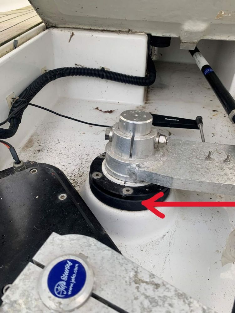

Quick update, dropped the rudder, inserted the Delrin washer recommended by Jefa and after reassembly, checked for plumbness by seeing if there was any movement in the bottom of the rudder, underneath the end of the rudder stock, moving when the rudder was turned over from port to starboard.  None was observed so things seem okay now.

When I purchased Ruby, my Hanse 370, she had just been fitted with a brand new rudder. The clearance was almost nil at the hard to port and starboard position. The solution was to remove the spacer immediately below the tiller arm and have a few mm skimmed off. This allowed the rudder to drop down and create the necessary clearance.

Hi Thomas Yde,
Jefa suggested installing a Delrin washer, specifically either M07-169 Washer, Delrin ø88.5 × ø119 × 4.5 mm (€20.11 per piece) or M07-169-B Washer, Delrin ø88.5 × ø150 × 4.5 mm (€32.68 per piece).
Since this was faster and easier, my yard instead purchased a sheet of Delrin and machined one themselves. You do need to drop the rudder to install it, but this was actually quite straightforward.
After installation, we could not detect any meaningful asymmetry. There is likely some minor asymmetry in the hull or shaft, but it is so small that it does not really matter and only becomes noticeable when the rudder has no clearance.
