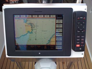

Hi
I have my GB 40 installed as shown on the picture by the local dealer. But it does not look professional especially the handset. Does anybody have a better sample? So I can modify mine.
Ozturk
Thanks
Enjoy sailing

Hi
enclose the picture of my GB40 installed from the factory almost the same

Skopea,
I have a setup with one GB40 screen and controller by the chart table, and one mounted in the cocpit as you. In your picture it seems like the plexi plate it is mounted in is cut beside the screen ?
I have a white plate where both the screen and the controller is installed. I can take a picture the next time I am onboard.
Sveino
Edit: here is a picture of how I have installed my GB40 in the cocpit.
