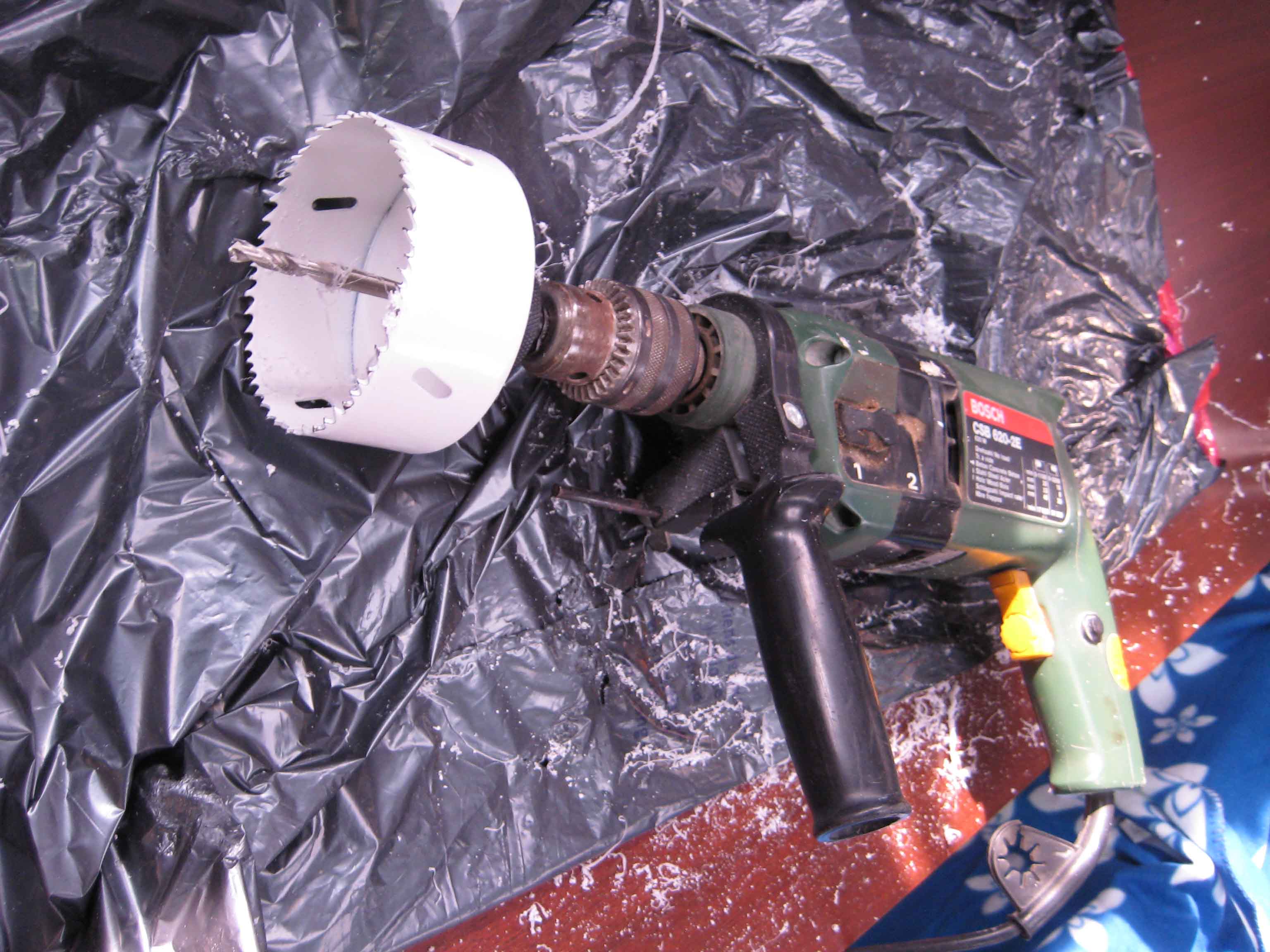

Just made a few holes
For extra ventilation, also added a few ventilation holes:

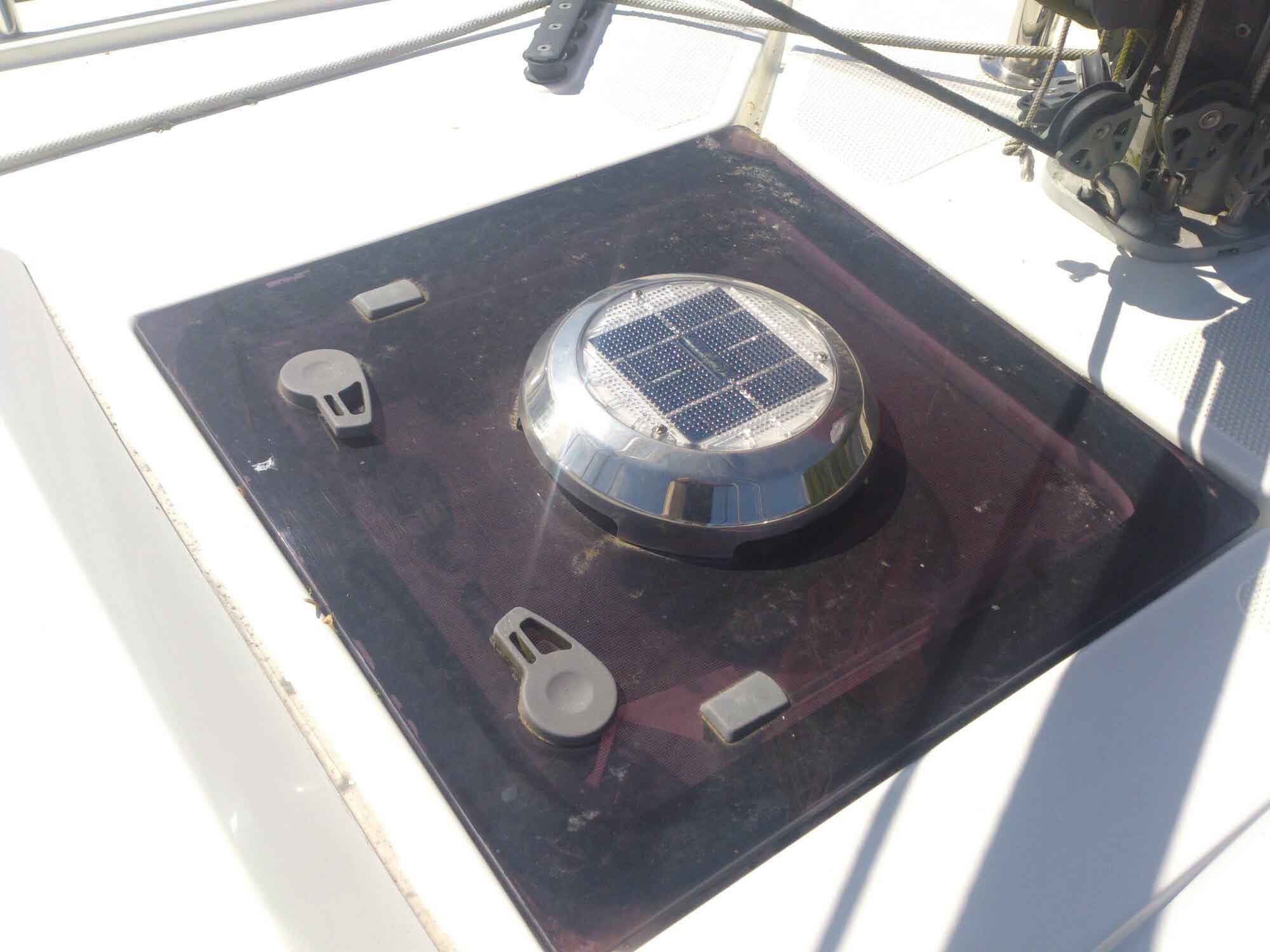

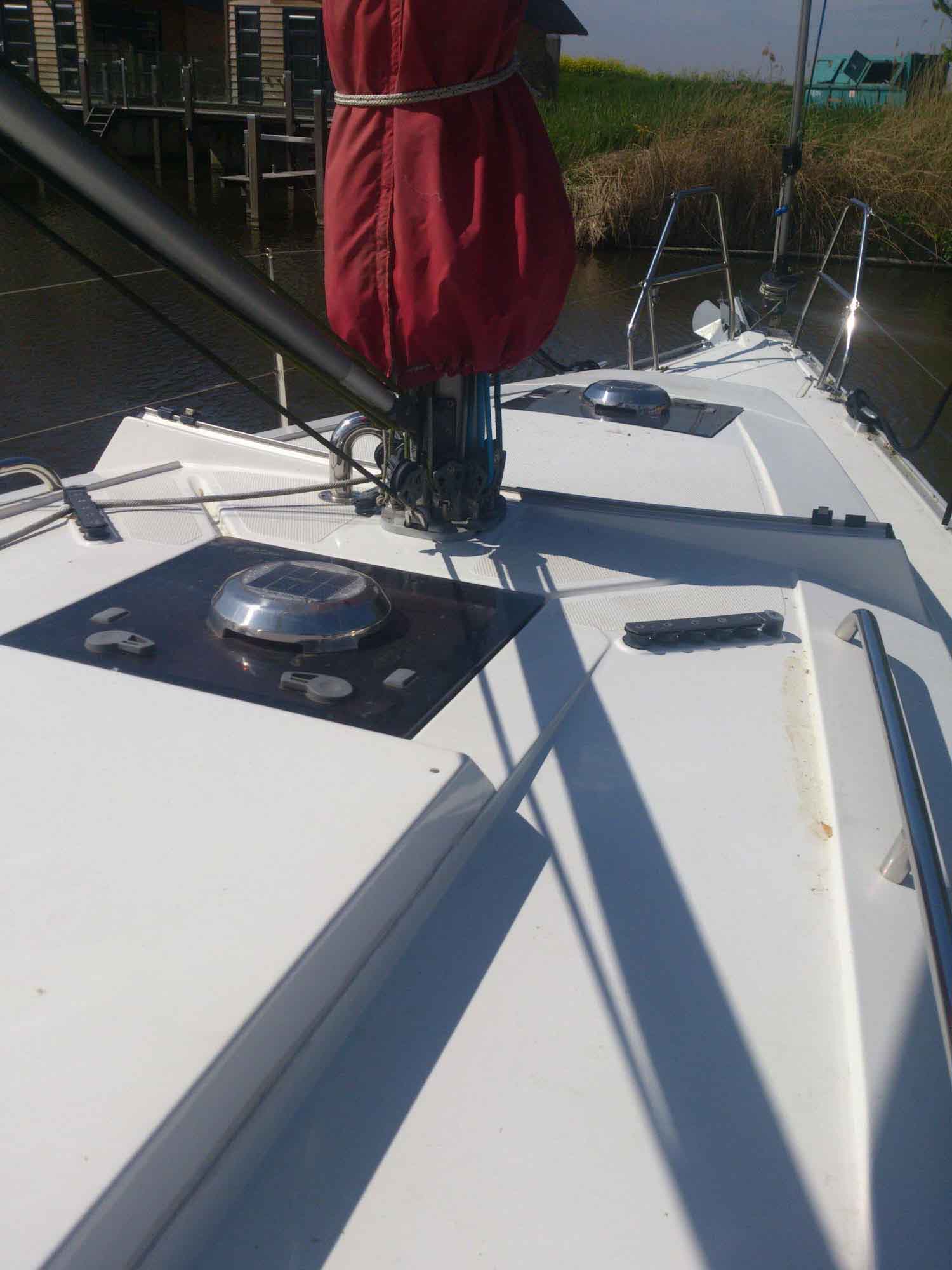

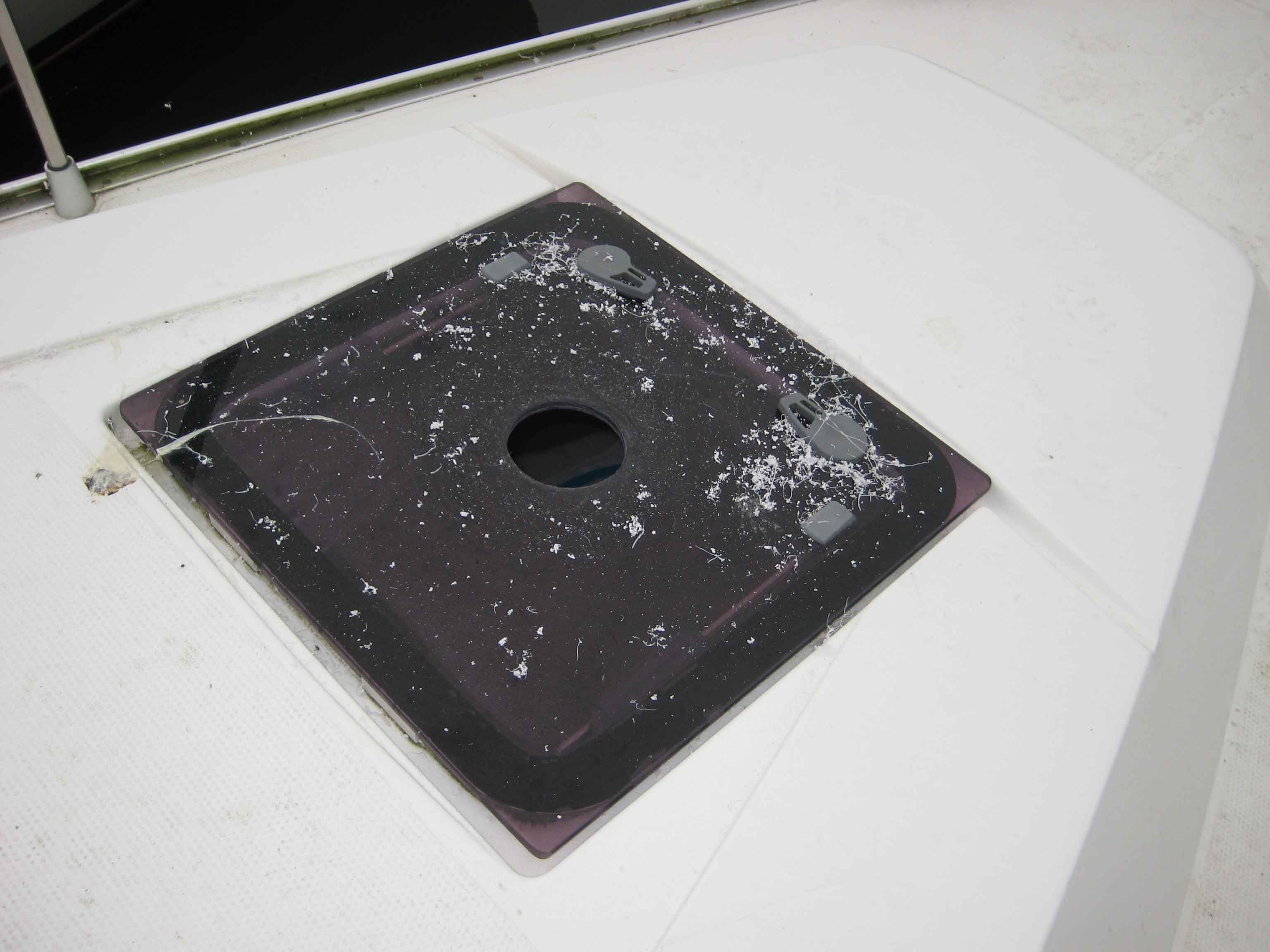

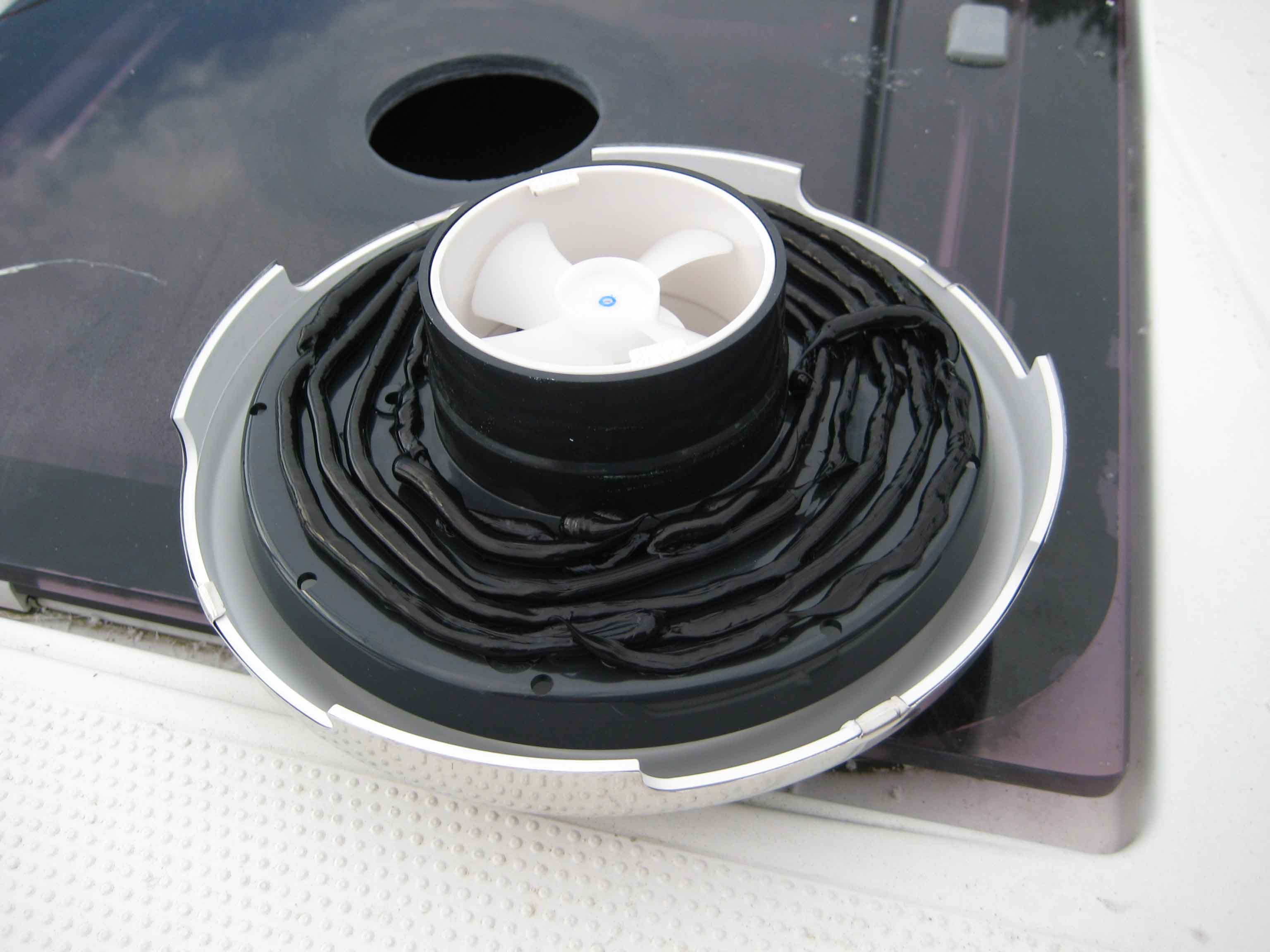

Ventilation is a weakness of the Hanse 320. I mounted two vents with solar panels (Nicro day and night) on both hatches and I am very satisfied. No more moist in the cabin. One of them pulls, the other one pushes.

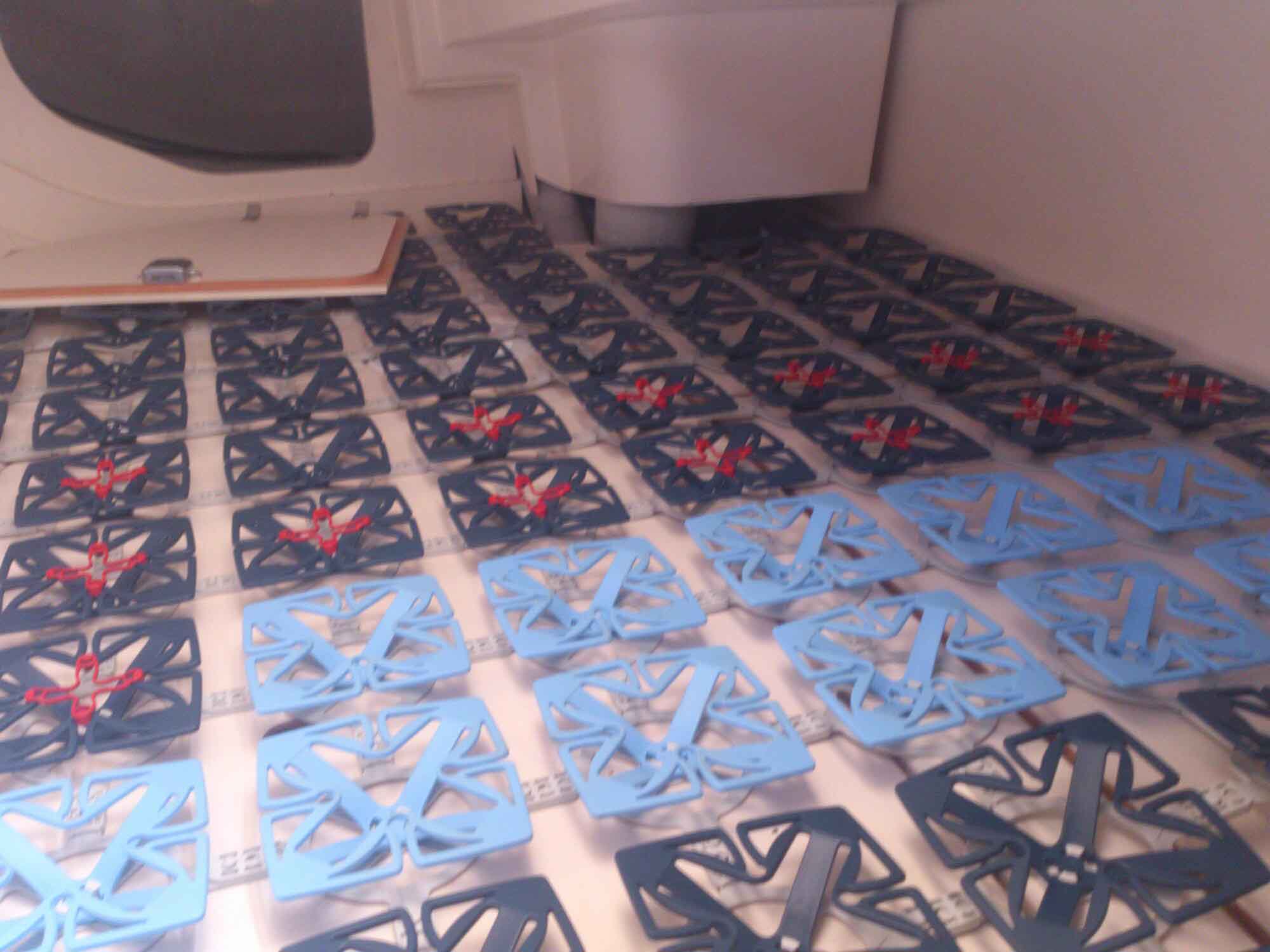

In the rear under the matrass I use a clicksystem (don't remember the brand now) witch gives space between bottom and matrass and works fine.

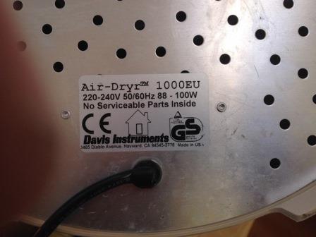

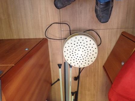

I bought  an air dryer on line from a company in Netherlands which has a European style two pin plug , so fits straight into the Hanse, and when I leave the the roof hatch cracked open a touch to ensure that the heated air has a place to escape and (touch wood) have never had a problem since. The Lewmay hatch is designed to be cracked open a small bit without letting rain water in. There has been no water coming in even with the very, very wet winter we have just had and down below no damp, no mildew, no mould.
And this is waht it looks like in operation.
I really cant reccomend this product enough. I think it cost about £70 including taxes.

Date Posted: 22 March 2014 at 07:30
Nice solution. Many owners of berths however, like mine, don't allow constant connection to the 220V net when not on board.

Following my previous posts on thi subject some photos of my ventilation-efforts.

I think Henrik has also got the same dehumidifier as me now.... It had won best unit for Boats in many magazines, etc.
