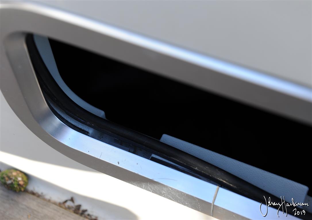

The rubber seal around one of the portlights has come off and I don't know the proper cure for it. I don't even know how it was attached in the first place. Glue? Glue would be the way I would try to put it back but would like to ask if anyone has solved a similar problem before or has a better suggestion.

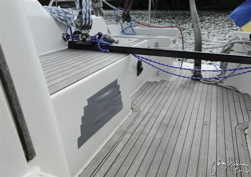

Seeing that I started this thread three years ago I have finally got around to order a new seal and try to fit it. It is bloody impossible!
So now I have put gaffer tape across the opening for the window. I am a bit pissed off.

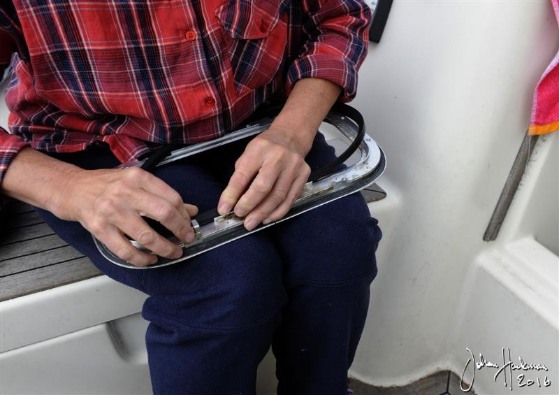

There is actually a guide, but it doesn't make a lot of sense to me: uploads/463/Portlight_New_Standard_Seal_Replacement.pdf" rel="nofollow - Portlight_New_Standard_Seal_Replacement.pdf
To me, not being a handy person, this problem is a hard nut to crack. The temporary solution (see below) is not very appealing.

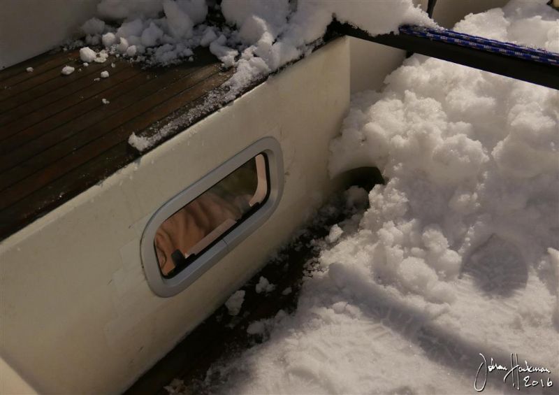

I gave up. I bought a new portlight. My dealer was kind enough to let me return the seal and get the money back.
It feels a bit awkward to replace the entire portlight just because the seal had got old and it cost me 170 Euro too, but at least the problem is fixed now. If you look at the first post in this thread this is a problem I've been meaning to fix for three years!
As soon as the weather permits I will remove the glue residue and polish the gelcoat. As you can see in the picture, tonight is not the time to start such a project.

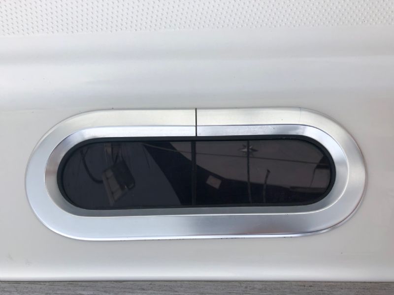

Date Posted: 30 August 2018 at 15:56
Hey Johan,
do you still have the correct part number of the port lights in the forward cabin?
The printing on the acrylic on my boat is so thin that some numbers have totally disappeared and my dealer is desperate...
Thanks!
Jörg
Hanse 388 LOUNA #173
Date Posted: 30 August 2018 at 21:41
Jörg, which portlight are you refering too? The small one above the cupboards or the big one?
Posted By: cintra
Date Posted: 31 August 2018 at 12:45
Hi, I mean the 2 small ones.
Date Posted: 02 September 2018 at 09:13
On the acrylic on my boat it says Lewmar Portlight and 00835 P 31C5.
Hope this helps.
