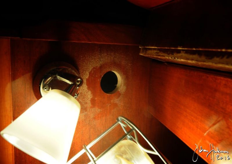

With today's need to charge your mobile phone overnight I have been thinking of fitting sockets in the fore cabin for some time. My daughter often plays on her iPad when we are sailing and I use my mobile phone as an alarm clock and I need it to be fully charged in the morning before going to work.
After having contemplated whether to use a cigarette socket or USB I decided to go for the latter and would like to share my experience with you.
I have one USB socket on each side and I take the electricity from the two reading lamps. The cabinets are built in such a way that there is 50 mm space between the outer wall and the inner one. This can be seen in the below picture where I have drilled the hole, so there is room for the cable and the socket itself. There was no need to drill a hole all the way through into the cabinet.
I plan to add switches to the sockets as I don't want and idle current.

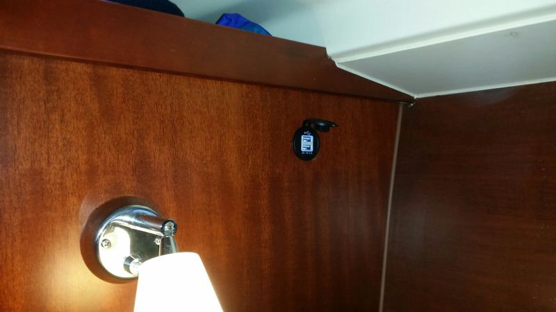

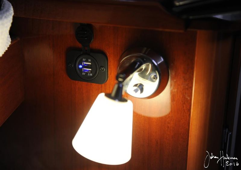

Date Posted: 03 December 2016 at 10:42
This is the result:

I just measured the idle current of my USB-sockets and it is just 0.01 Amps. I don't think this small current requires separate switches, or do they? If you want to turn them off you turn them off with the same two buttons for the cabin lights (starboard and port) on the switchboard at the chart table.
